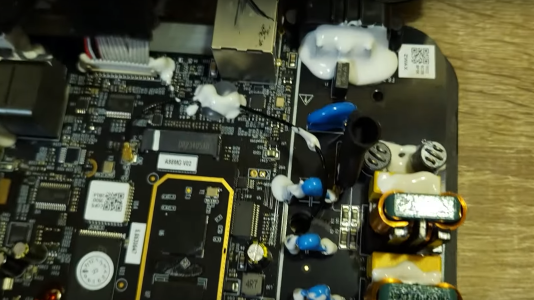

Okaay, danke. Aber für gewöhnlich hat die Schaltnetzteil Primärseite feste Anschluss Verbindungen für L und N. Über L läuft dein meist noch Sicherung und Netzfilter bevor es zum Schalttrafo geht.
Auch wenn es vllt klanglich nichts aus macht. Für das Gewissen wäre es schon besser :)
Ein Bild vom inneren wäre mal schön.

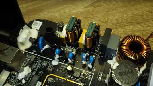

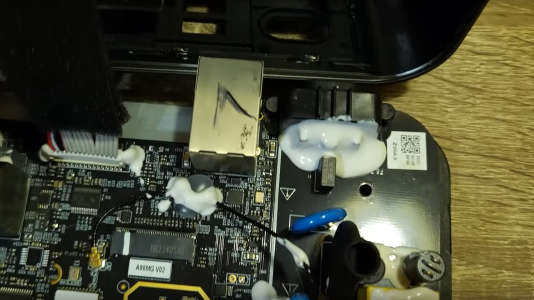

Okay, thanks. But normally the switching power supply has fixed connections for L and N on the primary side. Your fuse and mains filter normally run via L before it goes to the switching transformer.
That doesn't make any sense in this case since the plug in the external socket can be plugged in either way any time.
Even if it doesn't matter in terms of sound. It would be better for her conscience. :) :)
I hope it wouldn't. There's no security issue with the setup as is. The better power cord won't hurt, no matter which way it is connected. I hope you didn't go for a CEE 7/4 Type F SchuKo plug.
A picture of the inside would be nice.
I don't think there's anything to gain from that.
