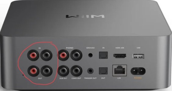

I am setting up my WiiM ultra. I have two speakers to which I want to connect via 3.5mm to RCA ports on WiiM. I thought there would a pair of output ports but there is only one. The other is labelled in. How do I connect two speakers? I figure best bet is a Y spitter.

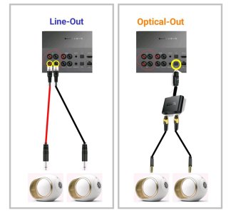

One cable is connected to the L of the Ultra Line-out and to Devialet A on one end. The other is connected to R on the Ultra Line-out and to Devialet B.
This is one example of how to connect two Devialet units for stereo playback.

If your Devialet can split the stereo signal from the optical into L/R and distribute it to two speakers (it probably can, but check the manual), you can also use an optical distributor and conversion cable. Possibly, the sound could be better this way.
Thanks mate - sounds like I need two ultras to run two speakers then as there is only one red/black out put.
I don't think so.
Do you want to use two Devialet speakers for stereo playback?
Or do the two speakers each need to output in stereo?
In the former case, connect the Ultra's L terminal to the minijack terminal of Speaker A and the R terminal to Speaker B as described above.
In the latter case, you can try connecting via optical (or 2RCA to 2 mini jack cable).
