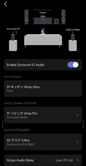

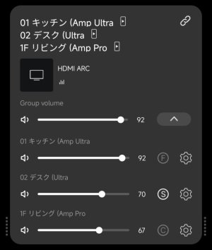

Yes, Amp can be linked as a centre channel.
Here, the fronts are Amp Ultra , the surrounds are Ultra and the centre is Amp pro.
On the device card, the centre speaker 'C' icon is greyed out and cannot be switched between L/R, so it is probably playing in mono. At this time, the Audio Settings screen also does not allow switching between Stereo and Mono.

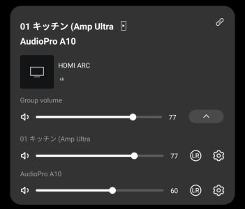

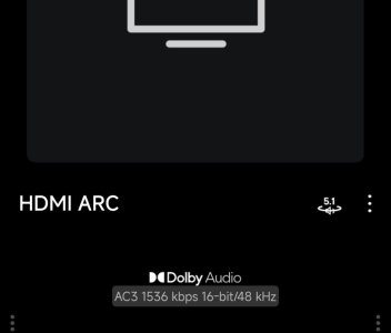

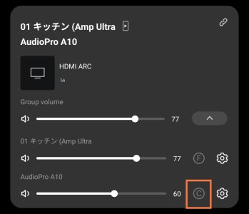

When creating a 5.1ch group, Dolby Digital audio must be output via the TV. After assigning one WiiM as the centre channel in the WiiM's Dolby settings screen, remove the WiiM intended for surround sound from the group.
The follower device on the device card will then display a 'C' icon, as shown here.
Next, when I play Amazon Music on the TV, the icon changes to 'LR'.
When I play a Dolby film again, it reverts to 'C'.

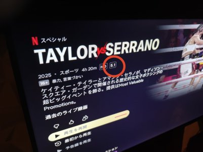

Are you seeing Dolby detected when watching Netflix? For some reason I’m not. When I switch to YouTube TV sources it seems to be there.
Yes, I have Doldy playback on both my Google TV and FireTV stick.
(My subscription is an ad-supported plan.)
Is 5.1 ch audio selected in the audio menu on Netflix video?
