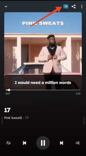

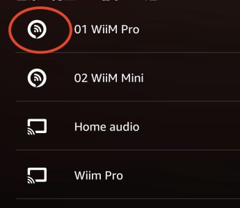

To cast to WiiM in the Amazon Music app, tap the square cast icon in the upper-right corner of the Now Playing screen. Then tap on WiiM pro in the device list. If you see two WiiM Pro in the device list, choose the round icon. The square icon is Chromecast.

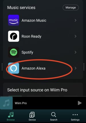

To use Alexacast, you must sign in to Alexa in the Wiim app.
WiiM Apps > Browse > Music Services > Tap the Alexa icon

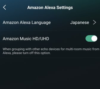

Also, turn on UHD in "Amazon Alexa settings".

Turn on UHD here as well.
Thanks that helped.
