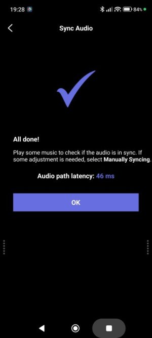

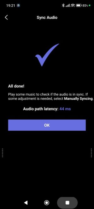

2、Connected the Mini to the WiiM Sound (Aux-in) and performed auto-sync on the Mini during group playback with the Ultra. 44ms
3, Connected the Mini to the Ultra (Line-in) and performed auto-sync on the Mini during group playback with the Amp Ultra. 46ms

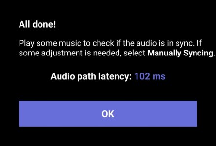

Btw, since I wasn't sure about that point, I also checked the Amp Ultra's Line-in.
Mini(Aux-out) -> Amp Ultra -> Speakers
As before, I created a group with the Mini and Ultra, and when I ran Auto Sync on the Mini, it was 102ms. It's odd that the analog has slightly less latency, but the results are nearly identical.
