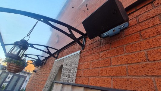

I'm getting some KEF Ventura 6s and just putting a speaker switch on my Kitchen Amp Ultra to change the output out to the KEFs mounted on the outside kitchen wall.

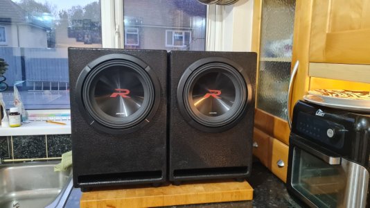

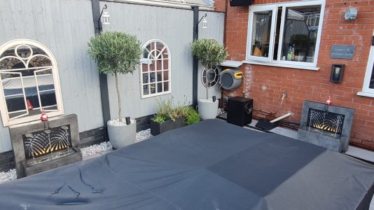

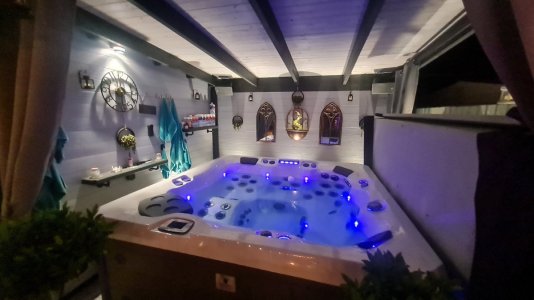

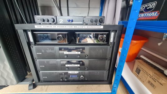

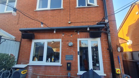

During the the back end of last year we did a full back garden make over. Seeing as I have a wiim ultra in my cinema system I wanted to continue with wiim products. Ended up using 4x monitor audio cl80 (2 on cabin, 2 on back of house), 2x monitor audio cl60 (at side of house), 2x monitor audio cl50 (at rear of hot tub) 2x Monitor audio m10 in the cabin. 2x alpine 10" subs in vented enclosures, 3 fosi power amps for cabin, hot tub & side of house speakers, 2 behringer nx3000 for the 4 cl80, and a behringer nx3000d for the subwoofers. Such a very good sound, but need to be careful with volume to keep neighbours happy!
