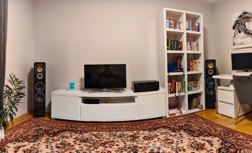

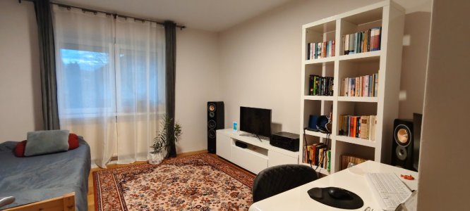

I'm currently using a Denon AVR-X2400H with Teufel Ultima 40Mk3 speakers.
I listen exclusively to music, FLAC files via Tidal.
However, due to issues with Tidal, I've already ordered a Wiim Amp Ultra to replace the Denon. I also want to get better speakers for the Wiim Amp Ultra (because of the booming bass from the Teufel speakers). My budget for a new speaker system is a maximum of €1500.
I have a few questions:
1. Are floorstanding speakers or bookshelf speakers with a subwoofer suitable for a 14 m² room? (My room measures 4 x 3.5 meters, and the listening distance to the speakers is about 3 meters.)

5. Due to the limited space and the distance from the wall (I've heard that floorstanding speakers always need about half a meter of space from the wall, otherwise the bass booms), should I buy bookshelf speakers and add a subwoofer? (Will I achieve cleaner bass with this configuration than with floorstanding speakers?)

6. I'm having problems with the bass on my Teufel Ultima 40 speakers (a booming bass, presumably due to insufficient distance from the wall). Can I keep the Ultima 40s? Since they support bi-amping, could I use just the tweeters and midrange drivers and buy a separate active subwoofer and connect it to a Wiim amplifier? Or would the Teufel speakers still only reproduce weak highs and mids? Should I just buy better speakers altogether?
My proposal would be to wait until you get the WiiM Amp Ultra, and then just run RoomFit with your existing speakers.
RoomFit is really good at dealing with boomy bass so that might solve your issue altogether. Close-to-wall placement causes bass bloom, but it also reduces SBIR cancellations - so it's not necessarily bad, especially when you have access to room EQ like RoomFit or Audyssey MultEQ. Have a look at this post for some explanations.

EDIT: BTW I'd only consider floorstanding speakers if you need high playback levels. This is what they are designed for.
