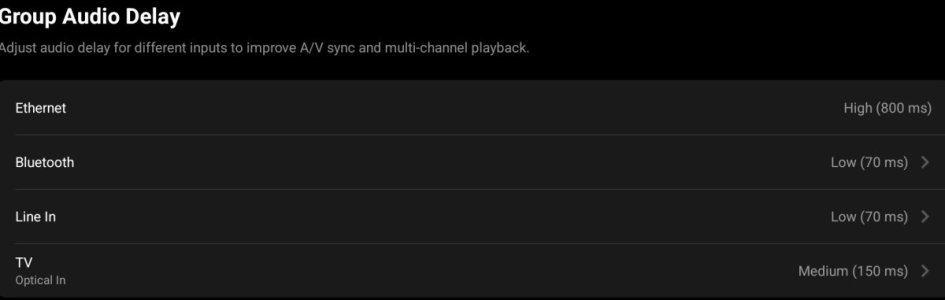

How much of a delay can you cope with?
tbh, even at 70ms I find that with tv input into such a wiim group makes lip sync barely noticable on the 'B' wiim.
