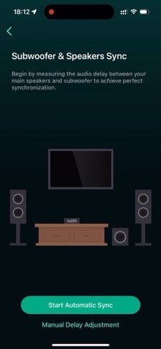

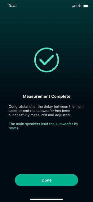

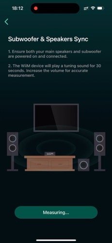

Hi WiiM Community,
We are looking for beta testers for the new Automatic Timing Alignment feature for Main Speakers and Subwoofer. This feature automatically measures the audio delay between your main speakers and subwoofer to achieve perfect synchronization. This feature is available exclusively on WiiM Amp, WiiM Amp Pro, and WiiM Ultra.
Why do we provide this?
When a WiiM device, like the WiiM Amp or WiiM Ultra, connects to your speaker and subwoofer, it assumes both audio paths have the same delay. However, if your powered speaker, amplifier or subwoofer adds extra audio processing, it can introduce a slight delay.
This mismatch in timing can cause the high and low frequencies from your main speaker and subwoofer to sound out of sync, affecting the overall audio quality. Our auto-calibration feature uses the device’s built-in microphone to detect and adjust these timing differences, ensuring a better blend of sound.
How to join this Beta?
If you are interested in beta testing this new feature, please provide your Wiim Forum username and MAC address in the Beta Test link.
October 18, 2024 Update:
Please download the latest app (Version 2.12.0) to test the Automatic Timing Alignment for Main Speakers and Subwoofer. The iOS app (Version 2.12.0) is available on the App Store, while the Android version is still under review by Google Play.
Beta firmware has been released for the WiiM Ultra, with releases for the WiiM Amp and WiiM Amp Pro expected next Monday. Devices will update automatically, or you can manually update by navigating to Device Settings -> Device Info -> Check for Updates. The beta versions are as follows:
- WiiM Ultra: 5.2.632652
- WiiM Amp: Coming next week
- WiiM Amp Pro: Coming next week
Thanks!
