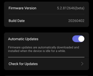

An auto-update toggle has been added in this beta version, but if I turn it off, will updates stop permanently? I seem to recall that the release notes mentioned you could set a specific time period. (It might have been about the delay of the reboot?)
Thanks very much for your feedback! We will check the root cause ASAP!
