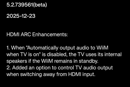

A new Ultra beta test for the HDMI CEC issue that has been present for a year now.
This time it looks like WiiM have made a solution that actually works for all?

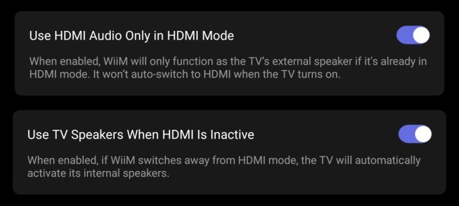

I do however still not understand why we need the "Use TV speakers when HDMI is inactive" toggle? I would expect that to always be the case when "Use HDMI Audio Only when in HDMI Mode" is enabled.
The text "Use HDMI Audio Only when in HDMI Mode" is also a bit misleading. Maybe "Activate HDMI CEC discovery only when HDMI ARC input is selected" would be better?
When "Use HDMI Audio Only when in HDMI Mode" is enabled the "HDMI auto-sensing" toggle should also be grayed out, as it cannot work at the same time.
Also why do I have to press "Done" to a HDMI connection popup each time I select the HDMI input? That shouldn't be necessary. The popup is fine if the connection fails but not when it's working ok.
All in all it does work as expected with my Sony Bravia TV, both with the new toggles enabled and disabled.
PS: The text in the beta test description is wrong. The toggle described don't exist anymore.

I tested this beta a bit. The results are good—at least on my TV, it's working fine without compromising any features that were previously functional. No issues so far 😄.
Also, I'm glad to see @hgo58's long-standing problem seems to be resolved. Peace has finally returned.
But as @hgo58 pointed out, I also find the names of these two toggles too long and hard to grasp. My suggestion is simpler, shorter names.
Alternative to "Use HDMI Audio Only in HDMI Mode"
HDMI Power Sync
(or) HDMI CEC Power Sync
This feature does not perform CEC power synchronization when WiiM input is not via HDMI, so I believe this name is largely appropriate. However, if this name is used, the feature must be enabled when the toggle is on (as before). And the default setting must be on.
Alternative to "Use TV Speakers When HDMI Is Inactive".
Use TV Speakers
On my TV, turning this toggle on enables simultaneous output to both the WiiM speakers and the TV speakers. Since the operation is explained in the description, I think the toggle name can be short.

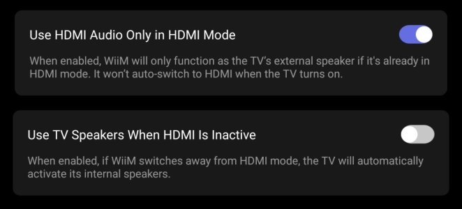

When the toggle is Off.
When I switching WiiM input to Wi-Fi and playing music, sound stops coming from the TV speakers. This is the same behavior as before.

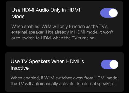

When the toggle is On.
When I switching WiiM input to Wi-Fi and play music, the TV speakers output the TV audio. At the same time, I can hear the music from the WiiM speakers.

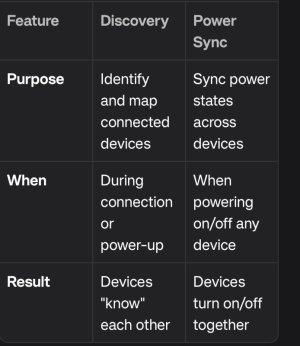

It's not a power sync. If it was, then the TV would turn on when you select the HDMI input on the WiiM. It's just a CEC discovery.
Use TV Speakers
It only changes the CEC discovery behaviour when you deselect the HDMI input. If disabled and you have selected another input one time, you cannot get the TV sound back to the TV internal speakers unless you reboot the WiiM (or change it on the TV, if possible). It doesn't make any sense to me. The discovery shall always follow the input selection of the HDMI.
Yes and you can't get the sound back to the internal TV speakers then.
This is the only sensible behaviour to my opinion. The TV sound is following the WiiM input selection. So no need to have both toggles.
To my knowledge, this is a feature called HDMI Power Sync or HDMI Power Linkage on the AVR. While you can' turn on the TV when powering on the WiiM, the WiiM's power will synchronize with the TV's power on/off.

When the "Use TV Speakers..." toggle is off, my TV speakers are not used. When turned on, the TV speakers will always be used when input from the WiiM is not via HDMI.
It works as described.
No. Discovery and Power synchronization is two different things. WiiM correctly implements discovery.

It does.
