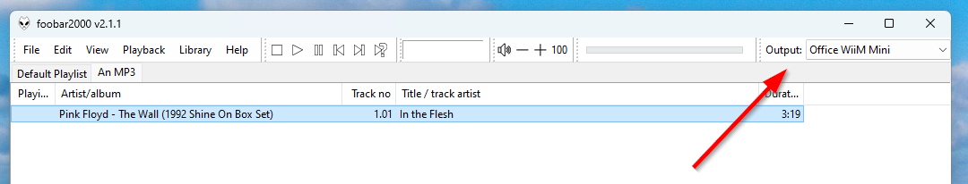

Local files can be streamed with upnp to the WiiM using Foobar2000 with upnp media renderer plugin

I'll try Foobar first and see what happens
Obviously I am doing something wrong. Foobar installed and it plays through the Bluetooth with all its jitters
As I say, I'm a total NOOB to this
Thanks, I now have Foobar UPNPing to the WiiM (y)
