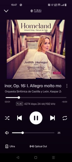

Same issue here. For a while it would skip at 2:36 each time. Other times completely freeze with the spinning wheel in place of the Play button. Same issue with Tidal on my Mini.
Also in Canada no VPN.

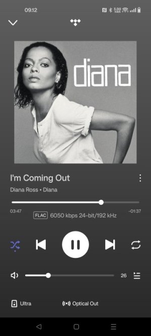

This is not a general issue. I can play any high resolution track from Tidal without issues on the WiiM (tested on Ultra and Pro+)
This is true for both the WHA and the native Tidal app (Connect). This is also expected, as it's always the WiiM that request the data transfer.
That is really odd - I tested 2 of my Wiim devices a few hours ago and both times Tidal failed to connect or play, now it seems to be acting normal. I wonder if Tidal have fixed something in their backend - both Tidal and Wiim apps have not had an update in the last few hours!
