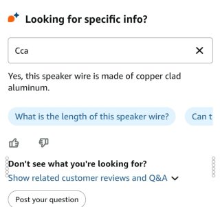

Basically the same price as the entry level speaker cable (e.g. Amazon Basic and Monoprice). The cheaper brands are usually copper coated aluminum, which I would avoid given how cheap the oxygen free copper cables are.
When did CCA become a thing? It was never even considered back in the day.
CCA is coming from Asia as a cheaper version than pure copper. Many people do not know the difference. But it is not that much less expensive than copper.
