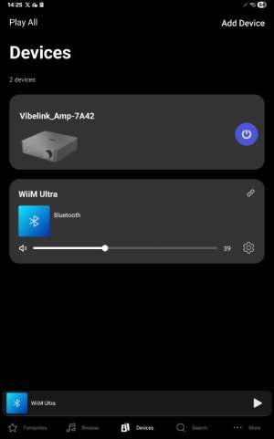

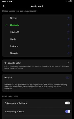

Another problem possibly..... Amp and ultra sat doing nothing but powered on, after a few minutes the ultras screen shows Bluetooth icon, checked the app and it's changed the input 🤔
This didn't happen using regular RCA cables...

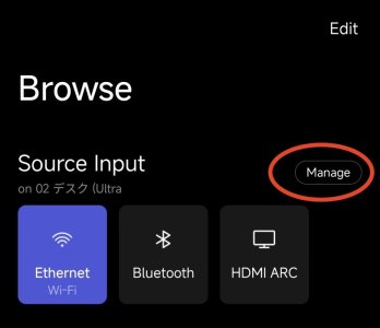

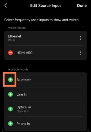

Or you can hide unwanted inputs in the input management on the WiiM app browse screen.
