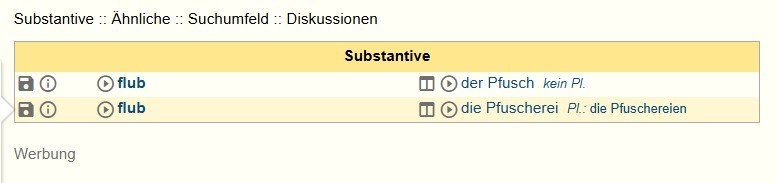

I was quite surprised at how well the AI response seemed to describe the situation reasonably accurately, but I had to look up what “flub” was, because it’s not a slang word that I am familiar with.🤔
As has been mentioned in the forum, WiiM said they can't reliably extract the bit depth from the headers of an incoming digital signal, so originally always displayed 24 until they changed it to 16 after some users complained 24 was incorrect for input from a CD player iirc. If they changed it to "16/24" I think that would confuse matters more as that format is normally used to show bit depth/sample rate. Even if they changed it to "-" or similar, uses will still question what that meant. But now that you know the background, does it still matter what it shows?
TBH personally I don't care much for what it shows. But I am a strong contender of 'if you do it, do it right'. If in doubt it shouldn't show anything at all.
The diminutive from flop?
I can't say how common it is but the word obviously does exist.
Probably used the WiiM forum as its source...
And re "flub", I thought you as moderator would have translated non-English terms as you normally do 😜🤣
