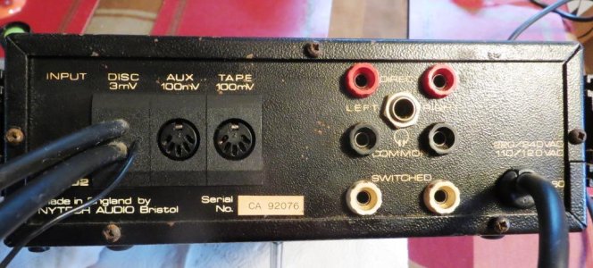

And now wish to plug our old amplifier into the setup. It is a Nytech CA202. The plan is to connect the Ultra via RCA into the Nytech, and then the amp directly to the speakers.
The input connector on the back of the Nytech is a 5 pin DIN with the text " Aux 100mv "
So before I blow anything up, can anyone advise if we should be ok ?

As @Ronnie D and @Valentino pointed out, the WiiM Ultra will work fine with the Nytech CA202.
The minimum RCA output from the Ultra is 200mv, so I don't know if that would work. I know one of the members use an attenuator so that might work
Thanks Ronnie, and thank you as well for the private message.
I've searched the Home app and found the audio settings for reducing the output to 200; so we'll try that and i'll report back.
As @Ronnie D says set the ultra to 200 mV. That should be ok. If it’s too much you can set all Ultra inputs to -6dB.
I presume you have an RCA to DIN cable, @Swan55?
thanks Valentino;
I'll be taking your and Ronnie's advice and set it to 200, then report back.
Yes I already have a converter cable; luckily, when we packed up the equipment I stored that as well (originally used to connect a Yamaha tuner to the Nytech).
