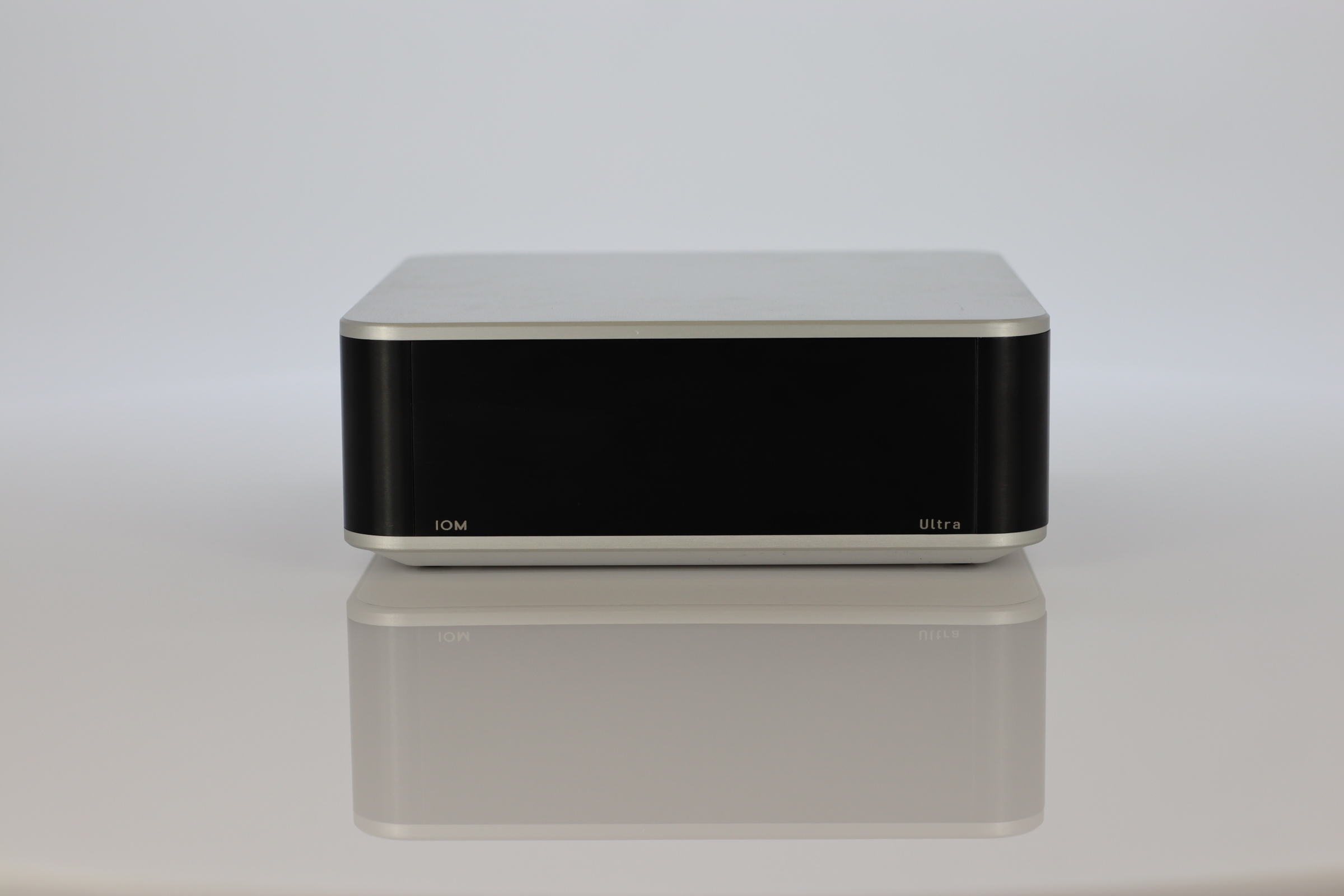

I went with IOM Ultra, as it has the look made specifically to match WiiM Ultra, also meets my needs (can drive my speakers in my room well) and is sent and made in EU.
