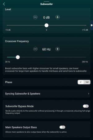

Curious as to the crossover point for the mains when using sub controller menu.
Just states cuts bass to speakers
At what point is this done ? Such as 50 hz, or lower than that ? Higher than 50hz?
There’s a switch at the bottom of the sub menu but no hz are mentioned
Which item are you talking about?
Subwoofer bypass mode
Main speakers Output bass
If you are talking about these two switches, the value set in Crossover Frequency will be applied.
So as for the picture of the menu (as an example)
The sub crossover is set to 60 hz , so that would be the crossover point for the mains?
