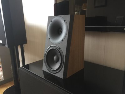

LR 24 HP and LP is a very good option especially with crossovers above 300 Hz. When I made my Hybrid active dsp speaker I kept coming back to fourth order crossover between tweeter and midbass, as the best sounding option.
Nice looking. (y)
