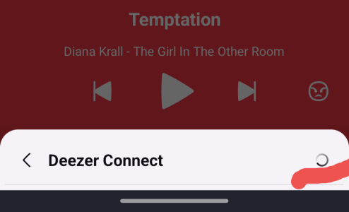

Deezer Connect not connect to wiim pro
Very bad. And who is to blame for this that the native application cannot connect and control playback on wiim pro? Deezer or Linkplay? The native application is much richer in functionality, I want it! And the stutters when the wiim pro application cannot start playing a track in Deezer and you have to juggle everything to finally start playing, who is to blame for this?
