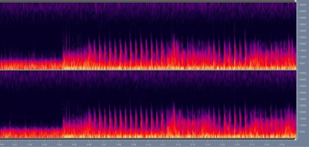

Feature request, in the order of descending preferences. Thank you very much for your anticipated related efforts:
(A) Implement a native DSD playback, or native using DoP. Note: If that may significantly reduce the DSP capabilities of the Ultra, that would be understandable. If that may not be possible, then ...
(B) Add the following to the Ultra's current DSD-to-PCM capabilities:
- Remove the ultra-sonic noise starting from about 30 to 35kHz and up. Note: The ultra-sonic noise is currently present, and can only make the downstream equipment work harder without any benefits.
- Increase the signal loudness by 6dB, or close to 6dB. If with 6dB the avoidance of the signal clipping may be difficult, make the increase of the signal loudness user-selectable, e.g. +3dB, +3.5dB +4dB, +4.5dB, +5dB, +5.5dB, +6dB.
- Convert DSD to PCM with the 88.2kHz or 176.4kHz sampling frequency, rather than the currently used 192kHz.
  • Recording with 96kHz sampling of the Wiim Ultra's analog output when playing a DSD track.jpg

For "option B", the WiiM can convert DSD to PCM on the fly, but does so at 192kHz. As @Alex Dunavski suggested though, the conversion to PCM should be a multiple of 44.1 for the sampling rate (probably 176.4kHz), and be raised by +6dB. And then there should also be a low pass filter to get rid of noise above ~30kHz that might be present when using PCM sampling rates 88.2kHz and higher. DACs will do this filtering automatically when decoding DSD, but won't with PCM. (Someone keep me honest here if that is the exception or the rule.)

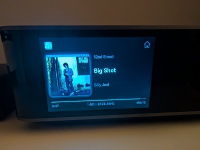

Doing some experiments with LMS/Squeezelite and this happened. Not sure yet if this is just a display error as I have found no way to confirm what format the Wiim Amp Ultra is actually playing here...
