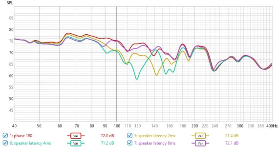

I have my subwoofer crossover set to 80Hz and phase set to 180 degrees in the WiiM app which seems to give the best subwoofer integration. I made some measurements in REW while experimenting with different latency settings for both sub and speakers. I expected to see the biggest changes at the crossover frequency but that isn't what happened. The biggest changes are above the crossover frequency up to 200Hz. I must be missing something, any thoughts?

I noticed that too when I ran sweeps it effects several locations not just one. So what might look best at the crossover point could look worse elseware, and vice versa.

Could you record the sub and mains output individually, so you can evaluate the effective acoustical slopes of the high pass and the low pass?

yeah he needs to do that, I did sub only, left only, right only, both speakers only, sub & both speakers responses

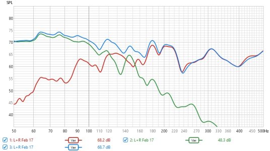

OK here is the separate sub and speaker response. Crossover is set to 80Hz but you can see the effective crossover is actually between 120-150Hz presumably due to the subwoofer being set higher than the speakers to avoid any boosts in room correction.
two very different types of slopes ;-)

The subwoofer's slope looks like a pretty clean LR4 low pass to me, except the crossover frequency looks more like 100 Hz than 80 Hz. :unsure:

Is the red line for both speakers playing in parallel?
What we can say for sure is that red and green are overlapping in a too wide frequency band and thinks exactly where the effects of different delay values show up.

Red is only the main speakers
Blue is sub and speaker.
This is with RoomFit on so large peaks in the bass region are cut.
My question was regarding one main speaker or both main speakers, because the output level is obviously different and the acoustical crossover frequency would look like shifted upwards with only one speaker. Now I read "the main speakers" as the pair.

Sorry yes both main speakers
