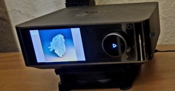

The Wiim Amp Ultra TPA3255 chip implementation is used with an LS with 99 dB and gets so warm that it heated up the Mac Mini that happened to be standing on it, which I find extremely surprising. The other Class D amps that ran before the Wiim Amp Ultra... hardly generated any heat at all.
Did you put the computer on top of the other amp, too? The Wiim case is its heatsink. If you put stuff on it, it won't dissipate heat well and will warm up more than if its exposed to free air.
This reminds me of the old joke: "doc, it hurts when I do this", to which the doctor replies "don't do that".
If you had a big old Krell class A amp with giant heatsink fins, would you cover the fins with something?
Is that a fan under the amp? How does it get any air to blow?
Although the Wiim Amp Ultra should power my speakers without any problems, it gets significantly warmer than the Class D amp from another company that has to power 18" bass speakers. The solution: Fosi offers fans.
It just happened, the Mac Mini wandered in and placed itself on top, like a cat does. :giggle:
No but seriously, don't do that. (See info from others in this thread.)
Other Class D amps have no computer board (streaming module), touch screen and other things the Amp Ultra has. It needs to breathe (no need for a fan) and is monitored en protected against overheating.

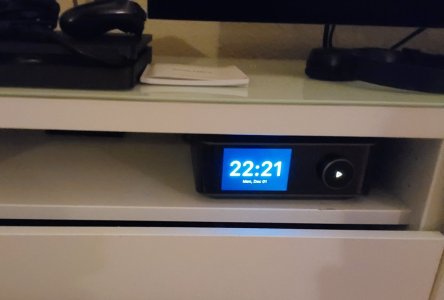

I just tried to measure with my IR fever thermometer. It reeds 41.2 celcius which is ok i guess. I don't have any other means of measuring this` is the setup: View attachment 30334
I believe a temperature of 41°C on the top panel is perfectly acceptable.
