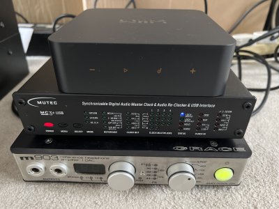

Sounds v tasty.
Qobuz @ 192 24 bit.

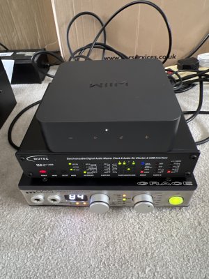

I may add an outrageously $$ Mutec 10x wordclock. I had one a while ago and its impact was huuuuge.
Coax out of Wimm Pro
Into Coax / BNC in of Mutec MC3+USB re-clocker then out via AES 110ohm cannon cable
to AES input of Grace M903
Added a TC Finalizer 96k+ (had it lying around)
I am using it to do some parametric eq, a little multiband compression and some "loudness" duties. (I have always been a fan of its "Digital Radience Generator" function (a sort of enrichment / loudness dsp possessing)
The TC unit is receiving external clock from the Mutec.

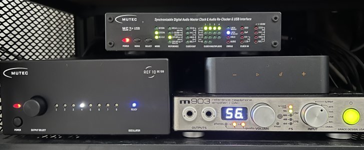

Update - removed TC Electronics Finalizer 96+
Added the Mutec Ref 10 SE120 wordclock generator
Now using Roon's parametric eq to both reduce a 30hz bass node (and treble boost for my hearing loss)
