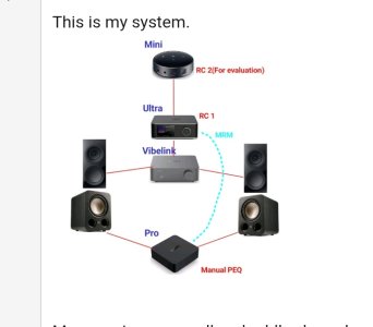

I have 2 subs connected in stereo to the Pro's line-out. I use the sub's low-pass filter in conjunction with the WiiM's PEQ; I use the MRM's manual sync to adjustment for the delay between the main speakers and the subs.

My sub doesn't have an accurate low pass filter, so I use a manual PEQ PK to adjust it closer to 24dB/oct, but it's not perfect. As @canard said, honestly it is not easy for me.
(But I am sure you will do better than me.🙂)

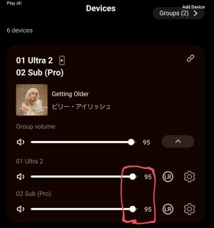

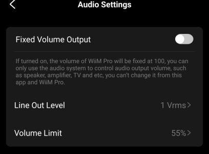

To simplify volume control for MRM group playback, I recommend first setting the WiiM app slide bar to the same value.
Then adjust by sub volume, WiiM line out level or volume limit.
