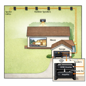

I have my WiiM in a garage connected to the amp that drives outdoor speakers. How to connect an outdoor projector?
ahtoh
Aug 12, 2024
5
Projector can stream to a Bluetooth device, but it's too far to the garage.
Any easy solution, maybe have the projector stream to a phone, that would then stream to WIIM via app or something?
