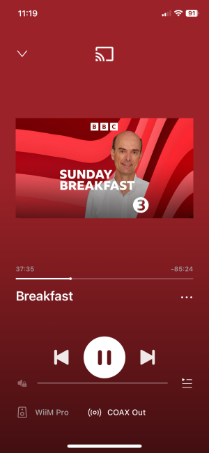

I have noticed that when a stream is cast from a stream app the reported bitrate is not accurate.
Just try a known stream app, say from KUSC or BBC, etc. cast that to WiiM and check the reported bitrate.

What casting method are you using?
It occurs both with Chromecast or Airplay. Probably too with Alexacast.
Examples:
Chromecast from BBC Sounds (320kb/s) it shows on WiiM 24 bit 48kHz.
Airplay from KUSC AAC 96 kbps, WiiM reports 900kb/s, 16 bits, 44.1kHz
Both wrong and inconsistent display of stream parameters.

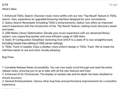

The Pro used to show sample frequency/bit depth of chromecasted streams. I no longer see them.
The info was removed in a recent app update as it appears there was doubt about their accuracy
Funny! The Chromecast UI was ‘enhanced’… by removing its characteristics.
Also… that firmware rev 2.7.5 was made a long time ago. With much more recent updates, even up to a week or so ago, I could see the sample frequency and bit depth…
It's the app, not the firmware. Was included in the latest update, at least on Android.
As per my screenshot, that app (not firmware) update was only two days ago on iOS. The android app update is similarly dated 22Dec.
