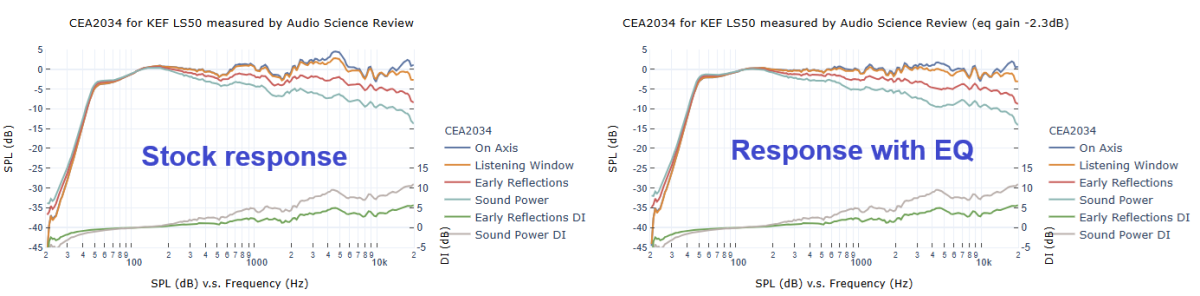

May I suggest to consider applying an anechoic response EQ correction for your LS50 speakers?
They have very nice directivity so should take EQ well.
(image source)
You can apply this EQ correction in any WiiM device, here's an EQ preset that should do the trick and take care of some of that forward character: EQ for KEF LS50 (link).
Note: You can omit the first PEQ band (at 102Hz), since low frequencies should be taken care of by RoomFit.
