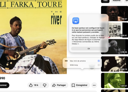

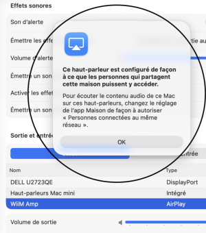

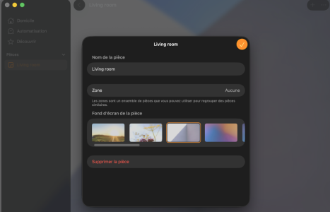

Hi,
the fact is that no sound is going out of my passive speakers via streaming from my Mac mini (2024) connected to Wiim Amp with HDMI cable. The HDMI output is correctly selected on my iOs app. However, music is played normally by Wiim amp on these speakers when using the free access radios from Wiim iPhone app (wifi connection in that case I guess). The problem comes from the Mac settings I suppose. When trying to select Wiim amp as the output (in System settings - Sound Menu), a window appears (see the screenshot attached) that says in french to change the settings of the "Home app" in order to authorize something like "connected people from the same network". Well, I got a look on that application and couldn't find a way to do so. The same happens when I'm on YouTube and try to switch the audio output in Airplay menu from Mac mini speaker to Wiim amp. The output can't be changed to Wiim and the same window appears concerning Home app, which I don't what to do with ! Do you have any idea what to dot set things correctly ?Capture d’écran 2025-11-09 à 13.40.32.png

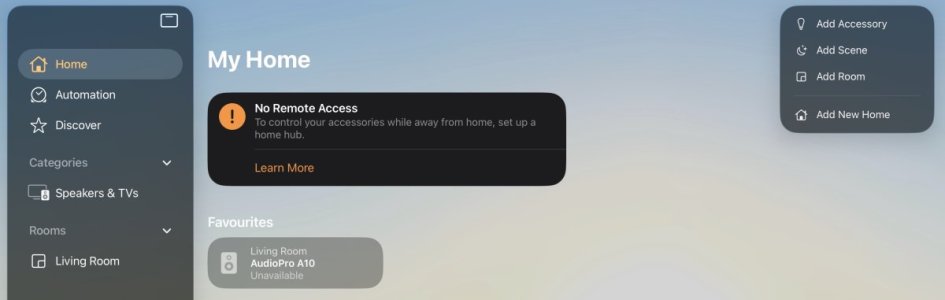

Back to your original post and issues with AirPlay, did you follow the instructions in this link using the apple home app on your iPhone?

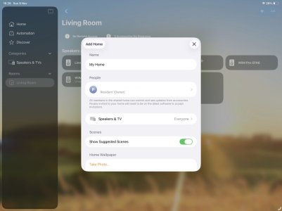

In that app, select your main room (living room in my screenshot below), choose the three dots in the top right hand corner, then home settings to see the pop up screen shown. The choose “speakers and tv”, and choose “everyone”. Hopefully that will resolve the permissions error on the Mac and allow it to AirPlay to your WiiM over your network.

Well, concerning Home app, as a (bad) coincidence (one more !), nothing appears like your screenshot ! I have created a living-room as you did but nowhere I found the possibility to create accessories, so it cuts short to your procedure !

On the main screen, again in the top right hand corner there’s a “+” sign from where you can choose “add accessory” and on the pop up screen that opens, choose “more options” to allow it to scan the network for your WiiM devices.
After that, the three dots in the corner, and “home settings” should bring up the speakers&tv option from where you can choose to allow “everyone” access

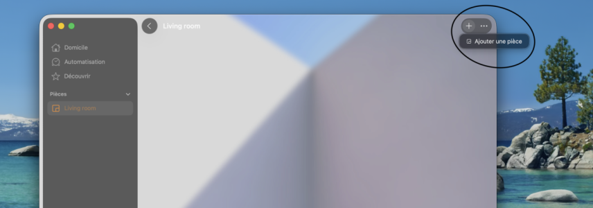

When I select "+" sign on the main screen, only "add a room" appears (= "ajouter une pièce" in french), but no "add accessory" anywhere (see screenshot below)

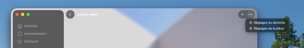

...and when I select "..." sign (= three dots), I got choice between "Home settings" and "Room settings" (= "Réglage du domicile" and "Réglages de la pièce", in French). Then , if I select "Room settings" I get the same window as on the previous screenshot.
I get this menu whether I select “home” or “living room” in this screenshot from the Apple Home app on my iPad Air 13 on iPadOS 26.0.1 - I’d need to investigate in what circumstances, like yours, that menu doesn’t appear.

Ok, as I said I’m using my iPad and the app there. Sounds as if you may be in a catch-22 situation until the iOS Home app is fixed although I might have expected the macOS app to function the same. I’m probably at the end of my Apple knowledge as I don’t have a Mac, so unless someone can pitch in with further advice, you may need to go down the physical cable/converter route rather than pursuing a fix for AirPlay. Sorry and good luck…
