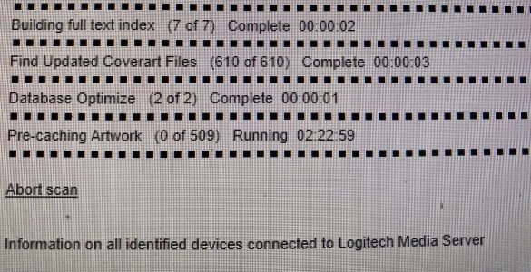

Trying to get some sort of decent UI running on Wiim Home app. Have added some recommended plugins, and rescanning LMS library. It appears I am stuck on pre-caching art work, been at the task for going on 3 hours so far.
Is this normal?

The pre caching of artwork depends upon how many albums you have and the size of your cover art files. We can’t see how many albums you are scanning from that screenshot. However I have known that process hang on first run. You may have to reboot the device.

The scan progress shows 0 of 509, so I thought that meant it was working on that many files.
