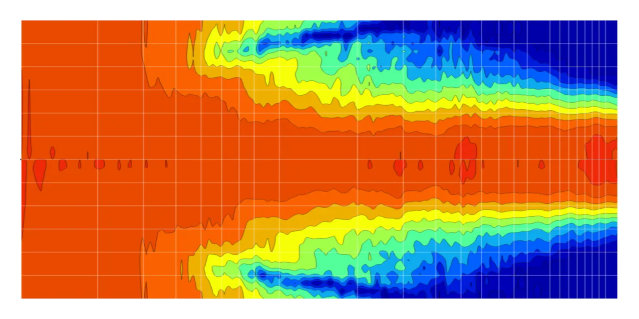

I'd love to have speaker correction independently from room correction, like e.g. Lyngdorf has it. :D
Take e.g. the spinorama data for your speaker as found on the Internet or perform your own measurements, if you can, and correct ahead for irregularities of the speaker, no matter what room they are in. Apply RC on top of that. :love:
No data for the brand new Q7 Meta so far, unfortunately.
