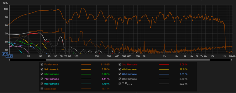

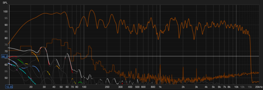

My WiiM ultra which I just purchased last week is showing a steep cutoff at slightly above 15khz
I looked for firmware updates and it is updated
EQ is off, 24/192 Coax to Fosi ZD3 DAC, XLR output to V3 Monoblocks
This cutoff shows up in repeated frequency response test in REW
I filed a ticket yesterday. Seeing if anyone else is having this issue
showing up when I use REW with a calibrated UMIK microphone, new Philharmonic BMR Towers (RAAL tweeters)

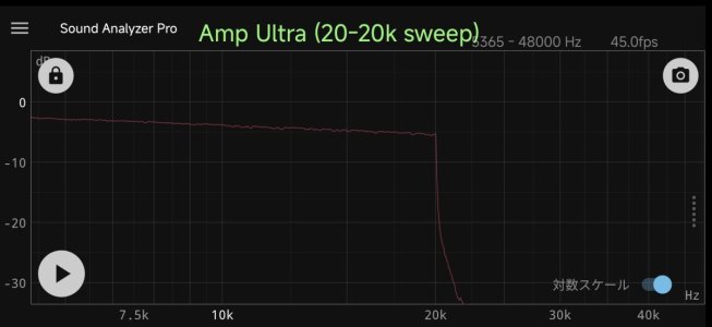

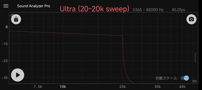

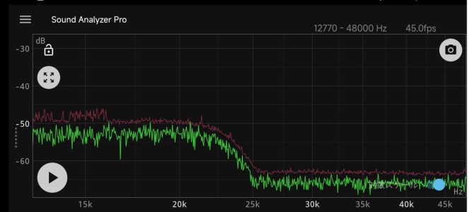

I was curious to find out.
I placed the microphone at a distance of 5 cm from the tweeter of my speaker to which the Ultra is connected, and played a 20-20k sweep.
As a result, my Ultra could play back up to 20k without any problems.
This is Amp Ultra.
At least my Ultra has no problems.
