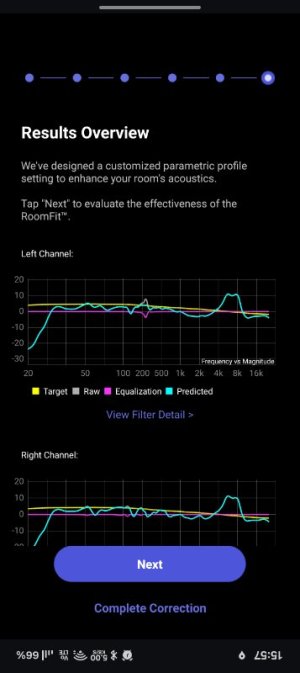

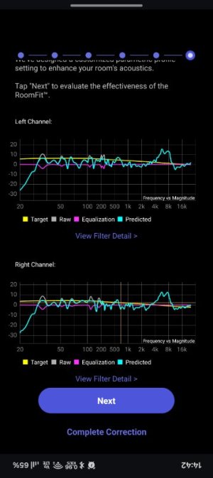

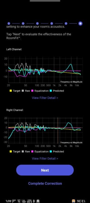

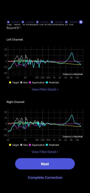

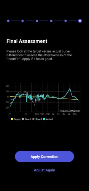

Hello All,
A month ago, I bought Wiim Amp ultra along with bookshelf speakers (polk R200) and an 8 inch sub (pioneer S-52W, it's an 8 inch down firing ported budget sub). It's setup in my small living room and is for music. This is the first amp+speaker+sub setup i have. So though iam close to 50, Iam a newbie. But i have read through a lot of information in this forum and has tried my best to get to my current speaker and sub placement. But I am not able to judge whether the sub placement can be made any better. I want to eliminate the nulls by moving my sub as moving speakers are difficult due to room constraints. After days of trial and error, here is my situation from roomfit. (Apologies if the screenshots are insufficient to provide any comments, can rerun roomfit and share more details in the weekend if needed)
Speakers are placed almost 6 ft(1.8m) apart and listening position is almost at similar distance (7ft) from the speakers . Speakers are in the corner close to the walls, 10 inches gap between the back wall and the port and 18 inches from the side walls. Sub is placed on the floor in front of the speaker stand of the right speaker as i felt it reduces the chance of they interfering with each other.
Roomfit in sweep mode gave the output as attached which shows dips at around 60Hz and between 150-180hz.
However roomfit in moving mic calibration mode gives better result - also attached (file name has MMC)
Physical controls on the sub are as below
Volume at 50%, crossover bypass is on and phase is 0.
On the wiim configuration for sub, crossover is set to 70Hz, phase is 0 and delay for main speaker is set to 8ms which was done by wiim auto sync and I tried to tweak it but 8ms delay and phase setting sounded correct. I have set input gain to -2.5 and used peq values above 400Hz based on spinorama values for the speaker. But I assume EQ is not applied during roomfit.
As for roomfit settings, I have disabled the boost mode (i.e enabled the setting), range is set 20hz to 400hz and smoothing at 1/6 and other settings are at default. I use the phones mic, so please ignore the spikes close to 8khz.
Iam happy with the sound but that may be because i feel i have spent enough time and feel i cannot do much better with speaker placement as it's a small room. But the roomfit showing the nulls in the sweep mode is bothering me and hence wondering if i should keep trying to find better placement for sub as for some tracks I think I hear the presence of the sub. Hence looking for guidance.
(Also want to say thank you to a lot of experts on this forum whose posts have helped me immensely to learn a lot that I didn't know a month before joining this forum)
Thank you.

This all looks pretty fine to me, I think you did a great job!
A smoother result isn't necessarily more accurate. :) You could try repeating the MMM RoomFit run with 1/12 octave smoothing and see if it makes a difference.
Yes, I wish there was a toggle switch do enable or disable EQ during RoomFit runs.
I'm not in your room and I don't have your ears, but I'd be surprised if the sub can really be localised with this setup.
If you could place the subwoofer closer to the front wall, you should give it a try. Personally, I would probably try to increase the subwoofer volume in the WiiM Home App by 2 or 3 dB (and re-run RoomFit, of course). It's easy to try and easy to reverse if you don't like the result.
My summary is identical to my introduction: Good job!

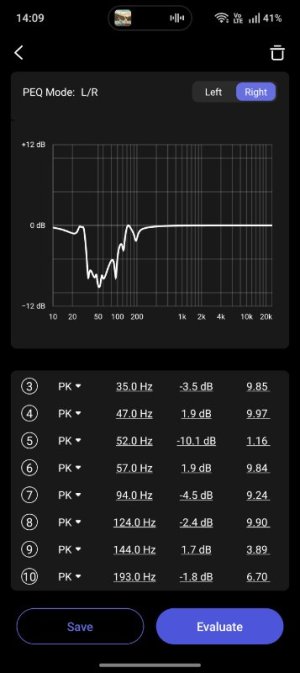

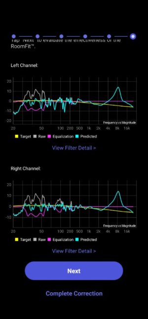

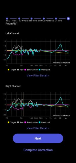

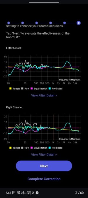

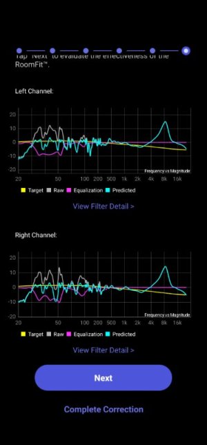

I re-ran roomfit but with some changes
1. I moved the sub into the corner as its downfiring, corner placement seem to have less negative impact. Both port and driver are downfiring in the sub (pioneer S-52W)
2. I switched to the new variable smoothing option
3. Because sub moved to the corner, both speakers are now pulled forward a little bit into the room .
4. I kept the sub volume -3db earlier, it's now set to 0db
Screenshots of the roomfit i captured are attached. I am overall ok with the result - i have shared the frequency sweep and others captured using a room correction android app after applying the roomfit.(I don't have REW)
I plan to adjust the cuts in the sub frequencies either manually or switching to a different target curve like harman to see if it can bring up bass a little bit as it's now feels significantly mellowed down. It may be also a limitation of the phone mic.
Thank you.

That looks pretty good, except perhaps the -10dB notch at about 48Hz.
What are your room dimensions, and how far is your listening position from the back and side walls?
Does this notch move if you measure e.g. 2ft in front of your main listening positions?
My advice would be to keep the B&K curve in RoomFit, and then adjust the amount of bass according to your preference using EQ (instructions here).
Note that as long as you don't use close to 100% volume in WiiM Home App there's no danger of digital clipping when adding a little boost with PEQ shelving filters. In case you use the "fixed volume" option in WiiM Home App then you should use the "volume limit" function to compensate for any boost you add with PEQ.

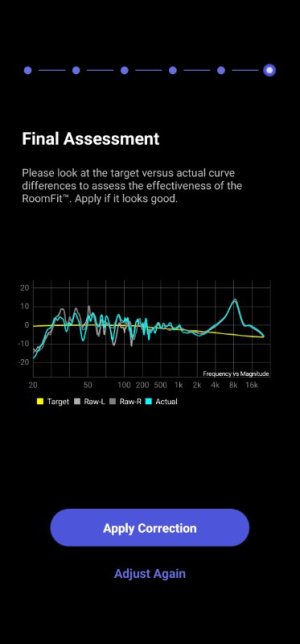

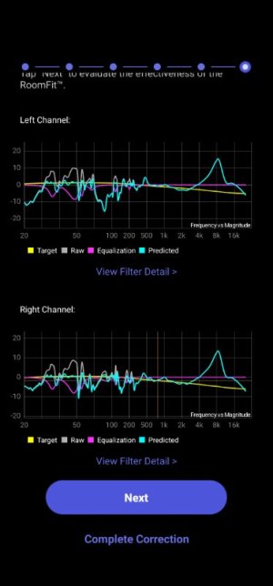

I measured once again with same settings with listener location moved 2 feet closer to the speaker side. The frequency of the dip seems same - please see the image. So looks like it's SBIR?
My sub crossover is 70hz and sub is in the corner behind the right speaker.
Iam also making some other adjustments to what's around the speaker to conceal some wiring and moving one furniture out of the room. Hopefully will be done in the weekend and will do more measurements with a plan below.
Let me know if testing with a plan like below makes sense.
1. Take measurements with the usual and one more listening positions (already done but can repeat once the wiring and furniture movements are done) with the current placement (sub in the right corner and speaker in front of the sub)
2. Take measurements with sub off and subwoofer calibration off to see what changes.
3. Take another one by pushing speakers closer to the wall and pulling the subwoofer in front of the speaker but closer to the side wall
4. Keep the setup the same as #3 above but sub moved away a little bit from the side wall
5. Move sub to the other side - in front of the left speaker and further from the speakers and back wall as i have a power socket there giving more flexible sub placement.
#1 will help to confirm whether it's SBIR, #2 to confirm whether the sub is the cause and then #3 and #4 are to validate which feasible speaker and sub positions I can have in the room to pick from the better. #5 is just to test and validate, but I can only go with either current position, #3 and #4.
Let me know your comments which ones makes sense and anything else is worth checking.

It seems to be SBIR after all, yes. Given that the dip is in the subwoofer passband (<70Hz) it should be related to the subwoofer position in the room.
At the moment I'd focus only on trying out a few different subwoofer positions. Try to move the sub to a few different places along the wall and see if you can avoid the dip at any of them. I see no need to move the speakers, at least not for now. The response above 70Hz is pretty OK.

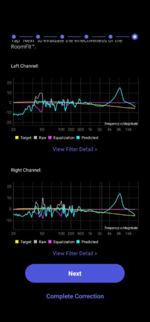

So I spent some time and I tried placing the sub in multiple locations but the results don't change much, the dip moves around little bit here and there but is always there in 30 to 50 hz range. So I paused roomfit attempts and started listening to sine wave tones from 30hz to 55hz and first confirmed that there is some sort of room resonance (I don't know how else to put it, may not be the right term) because it's cement plastered and smoothened & painted room walls along with vitrified tiles flooring (porcelain like flooring) used in this part of the world which reflects the sound a lot. I was also suspecting if my budget sub has flaws or it's characteristics of using the floor may be the culprit so i disabled sub out and tried playing the sine wave tones with speakers and it was the same. Though I can't pick out a dip per se, but I can see the volume levels fluctuate as I keep playing from around 35hz till 55hz or so generally everywhere in the room. Largely the same pattern whether i use the sub or not. I have not listened to sounds this carefully at this frequency in any rooms before and is relying on headphones, so I may be totally off as i dont have a correct baseline reference which I can get only if listen in an acoustically treated room.
I think my next step would be to keep the sub and speakers at designated places (visually and not based on sound as there doesn't seem to be much change to audio adjustment that is needed anyway within the choices i have) and see the best I can get through roomfit and EQ adjustments.
At some point I will try to validate with REW.
Thank you.
So that confirms the assumption that the dip is related with subwoofer placement. Good job!
The room is pretty small, so it's not that surprising that it is difficult to find a location without any dip.
Still, a dip at 30Hz would probably be less audible than a dip at 50Hz. This is because there's usually much less energy in recordings at 30Hz than at 50Hz. So it might be worth placing the sub accordingly.
Additionally, from RoomFit we see that your sub's response is limited at 30Hz at the low end, and your crossover is at 70Hz which sets the upper bound of your sub's passband. If you can place the sub in a way where the dip moves either below 30Hz or above 70Hz you are effectively eliminating it. And if you get the dip close to 70Hz (but not over) you can try to reduce the crossover frequency to remove it.
So I paused roomfit attempts and started listening to sine wave tones from 30hz to 55hz and first confirmed that there is some sort of room resonance (I don't know how else to put it, may not be the right term) because it's cement plastered and smoothened & painted room walls used in this part of the world which reflects the sound. I was thinking my budget sub flaws or it's characteristics of using the floor may be the culprit so i disabled sub out and tried playing the sine wave tones with speakers. Though I can't pick out a dip per se, but I can see the volume levels fluctuate as I keep playing from around 35hz till 55hz or so generally everywhere in the room. Largely the same pattern whether i don't use sub or not. I have not listened to sounds this carefully at this frequency in any rooms before and is relying on headphones, so I may be totally off as i dont have a correct baseline reference which I can get only if listen in an acoustically treated room.
Was this listening done with RoomFit enabled or disabled?
It is typical to have wild volume fluctuations at different frequencies in the bass when room correction (RoomFit) is disabled.
Optimal placement of subs and speaker + room correction EQ (like RoomFit) are intended to fix exactly that and make any bass frequency better aligned in level.
Note that traditional physical room treatment is not that effective at frequencies below 50Hz. Room correction EQ luckily is!

I did some placement attempts in the evening. Unfortunately very little change to the dips around 50hz, including one were only speakers were used.
Sub behind left speaker, sub in the corner close to the walls
Sub behind left speaker, sub away from the side wall
Sub behind left speaker, sub closer to the side wall
Sub in front of left speaker, sub closer to the side wall
Sub in front of right speaker at 2 feet away, sub closer to the side wall and closer to the listener compared to all other positions
Sub out disabled, only with speakers
I am uploading them here now, yet to look at it in detail as it's a bit late evening for me now. A quick look I had though makes me wonder if i misread it in the morning or environment was noisy or whether speakers are causing the 50hz dip too and introducing sub may be just moving it around. For some I missed grabbing the assesment screen. But I can get the RC PEQ for those tomorrow if needed.

Unfortunately no iphones at home. I tried all the above with wife's samsung S23 ultra which is the best i have access to. But i read it's better than my Oneplus 11r i used for previous measurements.
The other inputs you shared i will have a look tomorrow.
