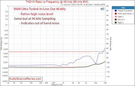

Its important to , in the WiiM meny select 24 bit 96 kHz ( the default toslink output resolution is 16 bit 48 kHz ) .
Theres a bug ( or was? ) that makes the ultra used as a dac sounding worse than it should when 16bit/48 is selected.
Amirs review at ASR shows this with 16bit 48kHz selected in the WiiM meny showing much worse measurement result than a ”real” 16 bit resolution should provide.
This goes away completely when selecting 24bit 96 kHz in the WiiM meny.
According to Amirm, there are some kind of noise shaping going on .

As I understand it , the 16 bit 48kHz resolution setting is not perfect when using the toslink input and the inbuilt dac of the Ultra.
There is noise in the signal , and that noise apparently goes away by using the 24bit 96kHz setting in the WiiM app.

If you are using the toslink output from a CD player into the Ultra, or a television toslink output and use the Ultra as a dac , you have some issues with the default setting 16/48 . The sinad according to Amirm is only about -85 dB if you look at the graph.
If you select 24/96 this issue goes away ( also seen in the graph .
I would guess that hdmi input on the ultra may have the same issue as toslink input.
But Amirm hasn’t tested that so no evidence of this.

I don't know how Amir produced that 48kHz wideband distortion graph but it seems to me that he is changing the source sampling rate, nothing to do with any settings on the Ultra.

I think the misunderstanding is in this sentence "Increasing the sample rate fixed that indicating that there is some kind of noise shaping going on".
The increase in sample rate is of the optical test input, not the WiiM digital output. This is defined by the test setup, not the WiiM.

So back to my comment #14 which I’d think isn’t an uncommon case, should users still change the seemingly unrelated optical output resolution to mitigate this “noise shaping”? And wouldn’t this be something that WiiM can fix in firmware?
That was my interpretation 👍
I would say no but it will not harm unless you need the optical output at 16/48.
I cannot imagine why the optical output resolution should be used for the DAC input resolution.
There were a fix some time ago about sample rate conversation and the way it is used by the LinkPlay connections. Maybe that also fixed this?
