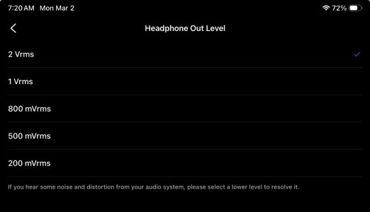

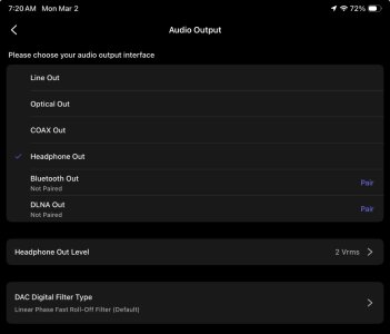

I have this on my Ultra.
I stand corrected! Guess that goes to show how little I use the headphone output ;)
Still, I'm pretty sure this is just a setting to match the maximum output level to your specific set of headphones - to get the best usable volume range. It won't change any of the characteristics.
It's a recent change, but somewhat misleading I feel as there's no way the headphone out does 2000mW.
Rated at 150mW at 32 ohms, so it seems this is just to align with the rca output screen.
At 150mV at 32 ohms, that is about 700 mW.

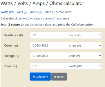

150mV at 32 Ohms is 700uW not 700mW.
Wiim support site states 150mW at 32 ohms.
mW, not mV.
So what does 2V at 32ohms mean in terms of mW, if the headphone output level screen really does indicate volts?
Is it actually 125mW? (That's what a quick google tells me.)
Maybe I need eat my words and the headphone output level screen is consistent after all :)
That's what you get for mixing up V and W...

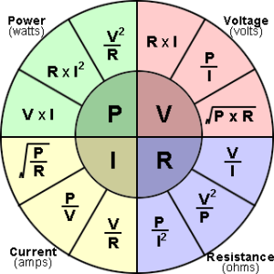

You don't need no stinking calculator ( just need to read your own ).
Ohm's Law
E = IR ( E is EMF, which is reflected by V.. volts... so V = IR ).
From which we derive the rest.
In this case,
P = V^2/R
and
V = SQR( PV)
It's best to use consistent terms, as in volts, ohms, amps, watts... otherwise you'll make the mistake I did upstairs and misread the output.
And, yeah, you don't need no stinking Internet web site to do these calculations. You should be able to do them, al least get into the ballpark, in your head.
So, that's the Physics... but the EE side takes into account the power available from the power supply. If there is not enough power to supply the current into a particular load, then you don't get the "perfect" solution. That's why many amplifiers do not double their power into half loads... as in many will do 100 wpc into 8 ohm, but will not do 200 wpc into 4. Amps that do tend to have significantly powerful power supplies.
One thing about the drawing below. Strictly from a Physics point a view an "X" indicates vector multiplication. So we never write P=V X I... we write P = IV or P = I dot V. These are scalar terms, not vectors.
OK, enough of Physics 102 ( second semester ).
Here: Ohm's equations.
