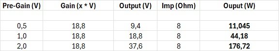

So I just learned the math.
Taking your specs here is what I get:
Amp: Audiophonics MPA-S250NC
Power rating: 250W into 4ohms
Gain: 25.5db --> 18.8x amplification of the input voltage
Assumed speaker impedance: 4ohms (you didn't mention that)
Max. ouput (into 4ohms):
Imput voltage 0.5Vrms: Volts to speakers: 9.4V --> 22.1watts
Imput voltage 1.0Vrms: Volts to speakers: 18.8V --> 88.4watts
Imput voltage 2.0Vrms: Voltst to speakers: 37.6V --> 353.4watts (this would drive your amp into clipping)
With your chosen setting of 0.5Vrms output on the Ultra the 22watts may seem low but it's the norm. In normal listening we're only using approx. 3 watts.

Thank you for taking the time doing this. But it is 8 ohm speakers in this case. My bad for mixing up the specs earlier, since it is actually 150 watts into 8 ohms. Does that mean 1 Vrms is the way to go?
It is easy to try it and see for yourself.
Just for you I restarted my PC. Sorry, can't do it in my head:ROFLMAO::
No, if the listening level is fine, stay there.
When I said earlier that 22w are within the norm you have to put this into relation with the speaker impedance.
So now 11w are fine🤣.
