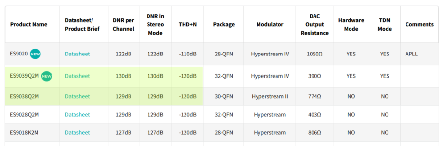

Are you sure about that? Have you got a link?
@Aquaman
Tnx, I stand corrected. Some earlier marketing mentioned the ES9018K2M in the Ultra Amp, but the final production version was upgraded to the newer ES9039Q2M.
However, the ES9038Q2M is allegdly still a more "Premium" tier chip compared to the 9039Q2M offering a lower THD+N at 0,00018% vs the ..39Q2M at 0,0005 - a 10dB diffrence
Straight from the horse's mouth:

And so, (a)I have learned something. The Amp Ultra makes the best it can out of a otherwise great DAC chip. Which leaves me with the second issue, what WiiM thinks of a future ICEedge 400A2 implementation in their amps.
Edit: @harkpabst
Thanks for the DAC datasheet. I guess they represent the potential for the raw silicone chip. The end implementation result relies - on that. Agree?
Sure. :)
The actual chip still defines the limit as far as DNR and SINAD goes. It's a sensible move to not only stare at the chip's datasheet, but if we are really looking at those numbers, no "better implementation" of the analogue output stage can make up for what the chip cannot deliver.
The Q2M family of ESS DACs provides strictly two channels. They also make multichannel DACs, where inputs and outputs can be connected in parallel to further reduce THD+N. One example would be the ES9038PRO. It's older than the ES9039Q2M and doesn't support all of its features, but it's a flagship 8 channel DAC, which - when used in mono mode for just one channel - can deliver a DNR of 140 dB and a THD+N of -122 dB. ESS say that this results in better "clarity and soundstage". Well, I guess they have to ... ;)
An integrated amplifier will always have worse SINAD than than the analogue output of a digital preamplifier. That's trivial (except for AI ;)). ASR have crowned few power amps to supply "DAC like performance", but that's not the full truth. Those select few amp can only reach their magical THD+N values if their gain is reduced to absurdly low levels. In reality, if you combine any power amp, no matter how expensive, with e.g. a WiiM Ultra, the real world SINAD will be very close to that of the WiiM Amp Ultra.
I'm not saying that the Amp Ultra is the best amp money can buy. It's certainly not. But it's very good and it's better than the original WiiM Amp and it's no worse than the WiiM Ultra (because you cannot even compare them - except when using the digital USB output, which circumvents the DAC in each device). :)
