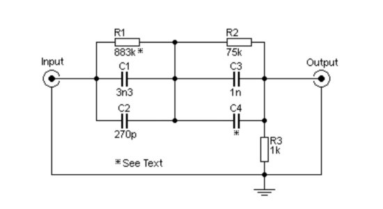

Alternatively, to rig up a phono input and allow the addition of a standard line input to it... you could look for a small ""RIAA inverse""
Something like that, but even if it is technically possible it
a. adds an extra stage of noise and distortion
b. requires a very precise RIAA curve → otherwise you get sound errors
c. it is unnecessarily complicated
There are good reasons why it is mainly a diy tinkering.
