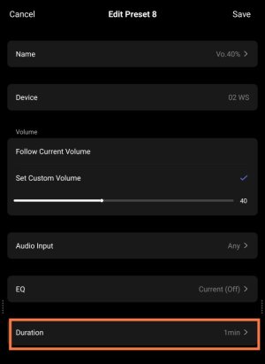

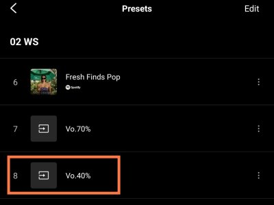

This is my preset screen.
Preset 8 has the volume set to 40% and the duration set to 30 minutes. (I changed it to 1 minute to test again.)
Preset 8 is an empty preset.
When I press Preset 6 to start music playback, then press Preset 8, the music from Preset 6 stops after 1 minute.

Preset 8 in the example given by @Wiimer explicitly says "Audio Input: Any". In this case I think it makes perfect sense if the duration is applied to whatever source (or preset) is picked next.
It wouldn't make sense to me for a preset that explicitly selects a certain source.
