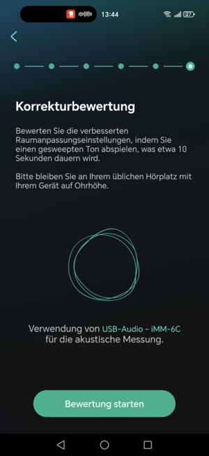

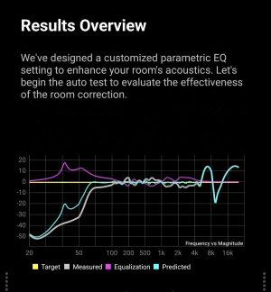

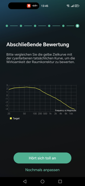

I got my WiiM Ultra last week. So far very satisfied. I then ran the room correction and now with the iMM-6C the calibration works, except for the one-time error message "Oh, the contact has been lost..." Unfortunately, I didn't take a screenshot. Since then, the correction valuation has created a meaningless diagram. The measured curve is missing. Reset and reinstall several times. Didn't help. What can I do?
Thanks in advance.
Arnim

That's not the problem. The evaluation result shows just the target curve (which is what it is, of course). But there's no measurement.

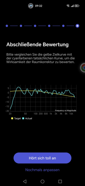

The RC is currently running again. What have I done? I tried with another mobile phone. WiiM home runs as the only app on the phone. No success. So my Honor Magic 5 Pro again. Then the PEQ curve actually reset and start RC again and suddenly everything worked. I thought the settings would simply be overwritten. Currently I'm not trying again "Never stop a running engine!". In fact, I turned off the PEQ. It turns off the bass below 50Hz that I've been working on for so long on the speaker side.
In addition, the measurement with the iMM-6C seems significantly better than that with the built-in microphones.
In my opinion, the Honor Magic 5 Pro's microphones are unsuitable. It's sad that you can't import REW data.
