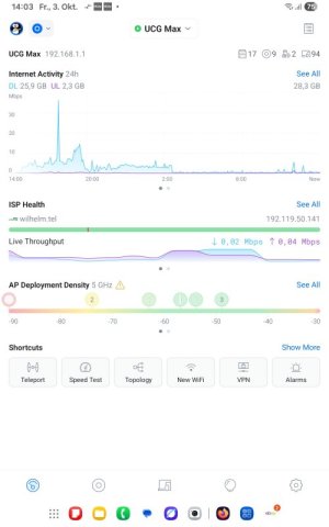

I have some here but they just sit unused in their boxes as I have a Unifi system which gives me control (too much possibly) over everything.

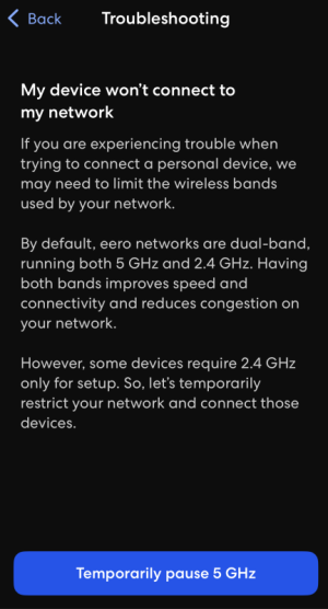

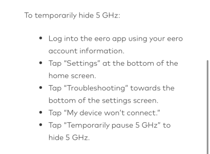

Can that make connecting some smart devices that only use 2.4gHz a bit of a bind? Some of the related apps don't seem too bright in allowing the router to select that band for the devices. Can you temporarily suspend the 5gHz band to force the use of the 2.4gHz band for such devices/apps?
There’s an option to disable 5ghz temporarily to connect reluctant 2.4 devices my friend had problems with his cameras but this sorted it
