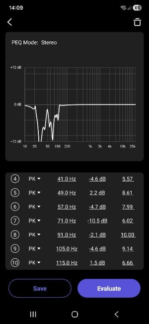

As seen in the attached RoomFit pics there's a huge peaks in my room at 30Hz and 70Hz and to fix these all the 10 PEQ were used between 20-115Hz leaving a lot of ripples between 115-300 that were not able to be corrected.
In the EQ/PEQ I've used 5 out of 10 PEQ to fill with Erin's spinorama EQ data above 300Hz for Polk R200.
In short term to be able to get 115-300Hz range better corrected should I just run REW sweep on top of current RoomFit and EQ/PEQ and get recommended 5 PEQs for that 115-300Hz range to be filled in Amp Ultra EQ/PEQ ?
PS: SQ for 2ch music is more important to me than movie
There's IMO no reason to try and correct the minor irregularities in the 115-300Hz range (unless you hear some obvious issues there).
There will always be some left-over irregularities in the response, but your response actually looks pretty good to me as is!
That is a good approach! I suppose you applied only the PEQ bands above 300Hz (i.e. above your RoomFit cut-off frequency)?

wouldn't the OP wish to reduce his subwoofer's gain, just a smidge, to avoid some of those 10db+ adjustments?
Up to the certain point can reduce the sub gain, but dips are not fixed very effectively as my below initial (failed) integration attempt shows. Obviously this did not sound good at all.

On the RoomFit prep side, wouldn't the OP wish to reduce his subwoofer's gain, just a smidge, to avoid some of those 10db+ adjustments?
IMHO @Gram1000 did well to keep subwoofer gain where it is, as that avoids the dip just below 50Hz after correction.
Perhaps this dip could also be reduced by alternative sub placement, but there's usually physical and aesthetic constraints on where the sub can go - so I see this as a reasonable compromise.
While the individual L/R corrections looks okay the summarized correction boosted bass -> will try next time to reduce the sub level even further.
Note that it is normal to get a +3dB bass boost when measuring both channels together vs each of them individually.
Multiple sources at low frequencies act as coherent sound sources so two bass sources sum to +6dB compared to a single source. At higher frequencies they start to act as incoherent sources so they sum to +3dB compared to a single source.
The net result is that you get +3dB more bass when measuring two speakers together (i.e. Stereo RoomFit) vs individual channels (i.e Individual Channel RoomFit).
Have a look at this post for some examples.
Note that this is not specific to WiiM or RoomFit - it is just physics of wave summation, so the same thing happens in any system.
Reduced sub level by 2db in Wiim and did further testing with separate L/R calibration and variable smoothing.
Also tried with Harman curve and saved it for my spouse as she likes to listen "boom boom" music.
Eventually landed back to B&K with stereo MMM calibration.
That looks very good indeed!
Note that instead of having two calibrations (B&K vs Harman) you could keep only B&K and then boost bass by the required amount with a PEQ low-shelf filter - which you can even associate with a preset (and even remote control button) for easy access. Instructions in this post.
