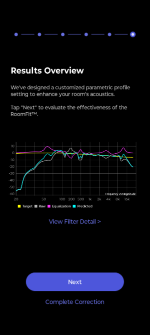

View attachment 29476View attachment 29477
What is your sub volume set to? It doesn't appear to be doing much. What is the crossover setting in the WiiM app? How does the response look without the sub?
50% on the sub 60hz down to 30hz in the settings
It's like it's atm only does down to around 50hz, it is set to 30hz

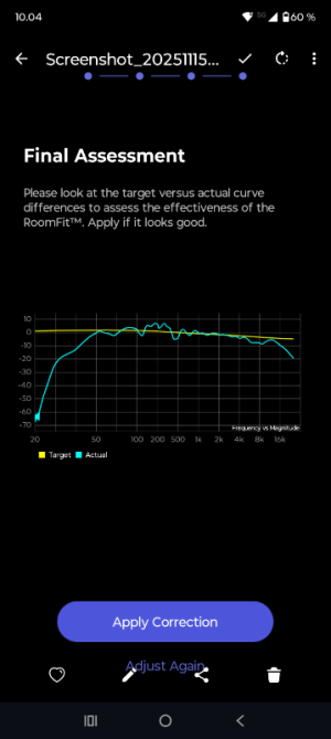

I think it would be better to compare it with the settings where the correction range is set to 35Hz–300Hz and the non-boost mode is turned on off.
Better but a couple of valleys around 125hz and 500hz 45hz is -5/6 db and 35-36hz -10db

I guess the 500Hz dip can't be corrected with EQ. The 120Hz dip might be resolved by moving the speaker closer to the rear wall; please refer to this post by @dominikz.
I will try again to adjust it, at 85% with non boost mode on my sub follows my front speakers all the way up to 100% with no distortion
So there is more to give before my sub don't have more power, mabye going for 40hz -5/6 db
If you increase the sub volume further, will it boost the 35Hz response?
But to be honest, I think it's splendid just as it is. And if it sounds good to you, all the better.🙂
