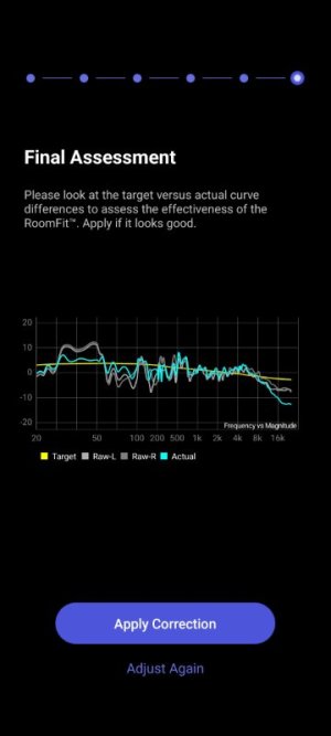

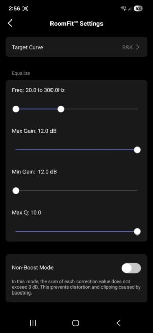

I'm bumping this to hopefully get some guidance on roomfit in my office following the addition of a wiim ultra to my system (Yamaha as501, dali spektor 2, no sub). It's a small room (3m x 3m) with speakers positioned either side of a desk on stands, pushed back against wall (as far as they'll go) and about 60cm from side walls. Sitting position is a couch hard up against opposite wall (only option given small room and need to fit desk etc).
Screenshots below show the roomfit settings (no advanced settings selected) and result, using calibrated Dayton mic. While I've had reasonable success with roomfit in my main system, this one is proving tricky and the resultant profile sounds pretty horrible (very muffled, lack of detail). At the moment, roomfit off and default 'acoustic' eq setting sounds much better.
Any suggestions for what I could try?

Given the unfortunate dimensions of the space, I'd suggest to try something a bit unconventional: push speaker stands to room corners (this way most of the SBIR bass suckout 80-100Hz should be fixed, and you should get extra bass headroom), and then re-run RoomFit which should take care of bass excess.
I'd suggest to enable Non-Boost Mode in RoomFit.
Given the unfortunate dimensions of the space, I'd suggest to try something a bit unconventional: push speaker stands to room corners (this way most of the SBIR bass suckout 80-100Hz should be fixed, and you should get some bass headroom), and then re-run RoomFit which should take care of bass excess.

OK thanks for the suggestions. I realise it's not an ideal space. I could push the left speaker into the corner but not the right as it's already just inside the door swing.
I see. In that case I'd probably stay with the symmetrical placement that you already have.
To mitigate you can do a manual correction by bringing down just the peaks at 60Hz (try type=PK, gain=-7dB, Q=2) and 115Hz (try type=PK, gain=-5, Q=5) and use a high-shelf (try type="HS", freq=250Hz, gain=-6dB, Q=1) to bring down the rest of the response to be in line with the bass.
With this correction you lose 6dB of output, but you should get a smoother bass response in return.
Note that the correction I suggested is just a starting point, the exact manual correction could be calculated if you can measure the response with REW.
I also did some further listening and it definitely sounds noticeable worse (really muffled/muddy) both on the couch and at the desk/nearfield.
You'd actually need to do separate calibrations for each listening spot, since it is unlikely the bass response will be similar at the couch and at the desk.
