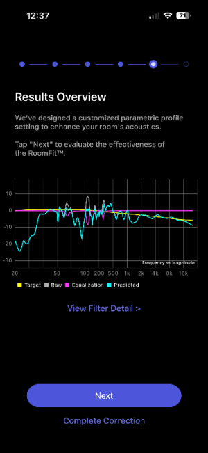

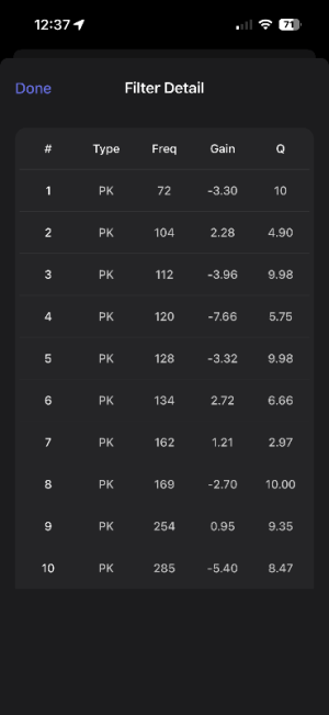

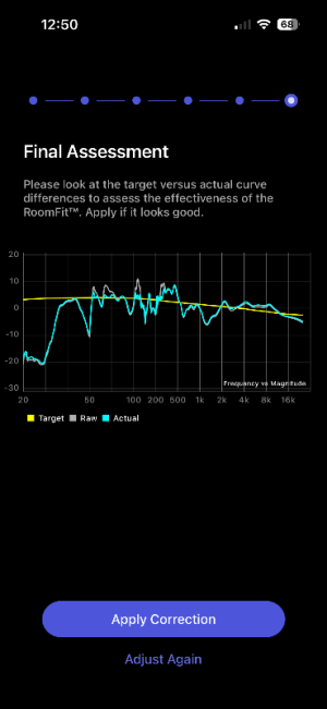

Hi all,
As the wife is out today I thought would start playing around with Roomfit .. What your thoughts on these results and is there anything obvious that I could do to technical improve the results?
Thanks for any help / assistance..

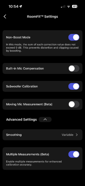

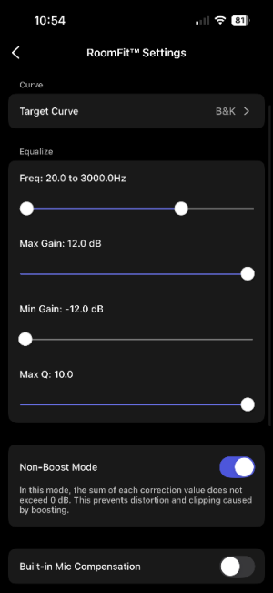

It looks promising!
The phone's built-in microphone might not be picking up the subwoofer's low frequencies, but there don't seem to be any major peaks or dips. As is often recommended, I suggest setting the frequency range to 20Hz-300Hz and trying a moving microphone measurement.
It looks promising!

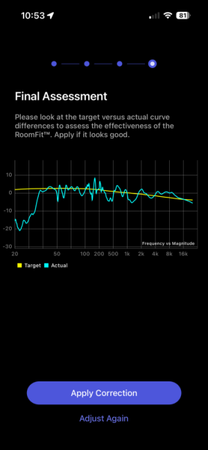

I’ve re run based on your suggestions..

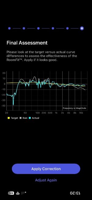

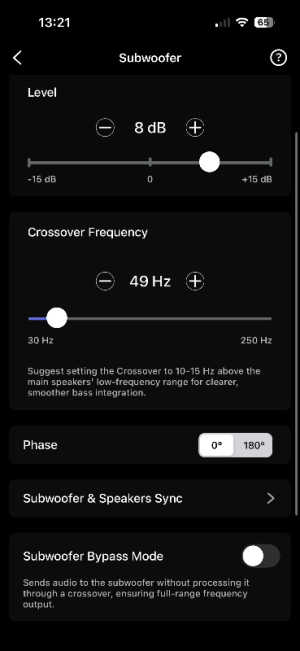

And my final attempt today :)
That looks pretty good to me. Good job!
Perhaps there might be some room to improve subwoofer integration by tweaking speaker/sub delay and/or crossover frequency in WHA, but it is by no means necessary and might not even make that much of a difference.
There's also a dip just below 100Hz which looks like it might be an SBIR notch, but it is narrow so may not be that audible in practice. How far are your speakers from the wall behind them?
And most importantly, how does it sound to you?
