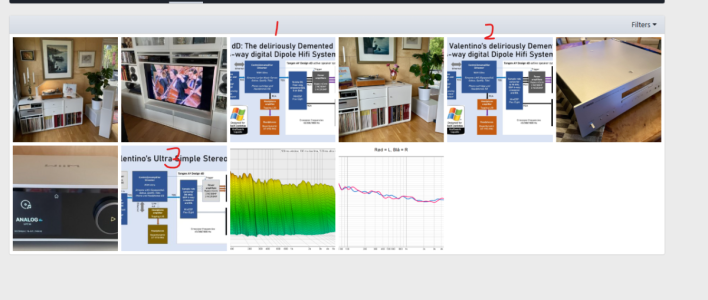

I improved on the Ultra ADC by using a MiniDSP Adept as its analog front end. Flowchart on my user page.
If you want to get the SACD layer to the Ultra it’s RCA analog only.
Which one?

Which one?
This is it:
drodledipolene-14-eng-wultra-adept-sacd-jpg.1124175

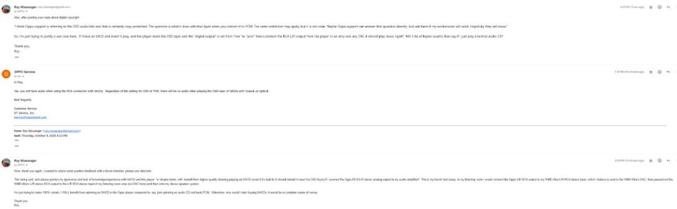

I just asked Oppo support and this was their response:
Due to copy protection, the DSD layer of SACDs cannot be output via Coaxial or Optical. You will need to play the CD layer of hybrid SACDs for output via Coaxial or Optical.

Me replying to Oppo Support:
Also, after posting your reply about digital copyright to the WiiM Forum:
"I think Oppo support is referring to the DSD audio bits and that is certainly copy protected. The question is what it does with that layer when you convert it to PCM. The same restriction may apply, but it is not clear. Maybe Oppo support can answer that question directly. Just ask them if my workaround will work. Hopefully they will know."
So, I'm just trying to justify a use-case here. If I have an SACD and insert it play, and the player reads the DSD layer and the "digital output" is set from "raw" to "pcm" then i connect the RCA L/R output from the player to an amp w/o any DAC it should play music right? Will it be of higher quality than say if I just play a normal audio CD?
Thank you
OPPO Service
7:14 PM (1 hour ago)
Hi Motley, Yes, you will have audio when using the RCA connection with SACDs. Regardless of the setting for DSD or PCM, there will be no audio when playing the DSD
Me Replying back
8:04 PM (35 minutes ago)
to OPPO
Wow, thank you again, I wanted to share some positive feedback with a forum member, please see attached.
This being said, and please pardon my ignorance and lack of knowledge/experience with SACD and this player. In simple terms, will I benefit from higher quality listening playing an SACD (even if it's hybrid, it should default to read the DSD layer) if I connect the Oppo RCA L/R stereo analog output to my audio amplifier? This is my bench test setup, in my listening room I would connect the Oppo L/R RCA output to my WiiM Ultra L/R RCA stereo input, which I believe is sent to the WiiM Ultra's DAC, then passed out the WiiM Ultra's L/R stereo RCA output to the L/R RCA stereo input of my listening room amp (no DAC here) and then onto my stereo speaker system.
I'm just trying to make 100% certain, I WILL benefit from spinning an SACD in the Oppo player compared to, say, just spinning an audio CD red book PCM. Otherwise, why would I start buying SACDs, it would be a complete waste of money.
Thank you.
