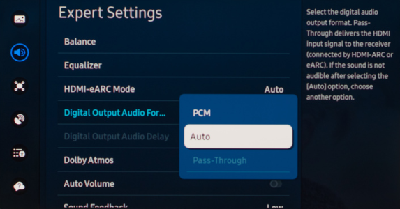

Is there a tv setting to change from earc to arc?
You'll likely also need to choose pcm output.

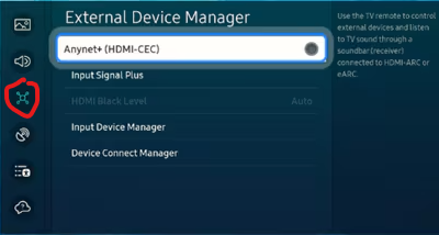

In the Home App go to device settings and make sure the Autosensing of HDMI input is switched to on.. I have a Wiim Amp and a Samsung LED TV as well (not the Frame) and turning on the Tv automatically turns on the Amp and after a second or 2, starts playing sound.
