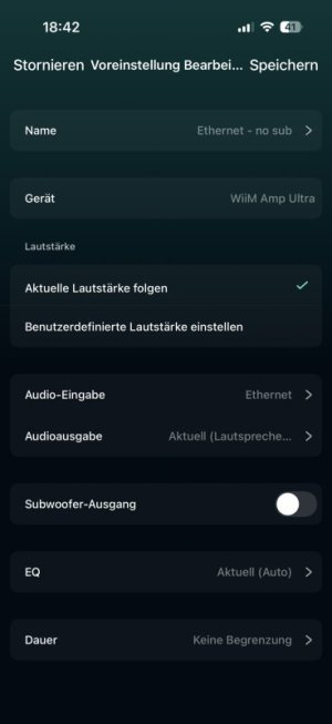

It's the Presets configuration page.
Presets (See All), then 3 dots.
Okay thanks I thought that was only for the music.

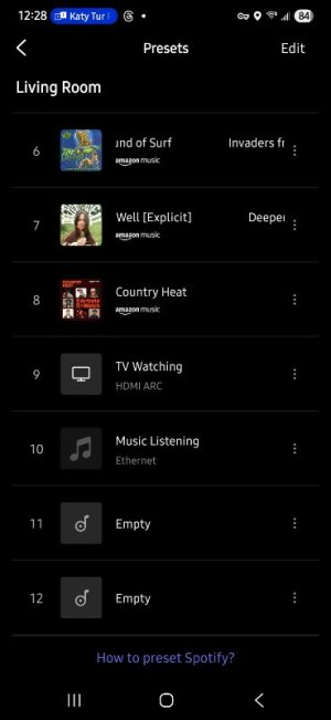

I think I set it up correctly.
I found a flaw in using the presets for this.
I have HDMI under auto sensing. When it automatically goes over it does not use that preset.
So having configurations assigned to the input would help here. I think you should raise a feature request to WiiM for this, explaining this use case.
