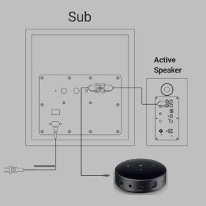

I found this on Amazon Japan, here is an example of how it connects to an Edifier M60. Replacing M60 with Echo would work.
Please forget about voltage 🙂
Thank you! It seems to be a better option than splitting the output, and as you say, connecting this way should work with the Echo. I have much to think about now.
